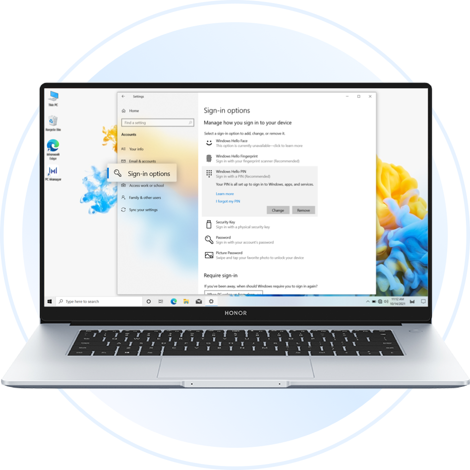

4. Reset Your PIN
If you have problems with the Windows Hello PIN, you may encounter a fingerprint unlock failure accordingly. Please sign in with your user name and password, select
, go to
Accounts > Sign in options > Windows Hello PIN, click
Delete, and delete the PIN following the prompt. Then click
Add and reset the PIN according to the prompts on the screen. Reset your fingerprint ID.
