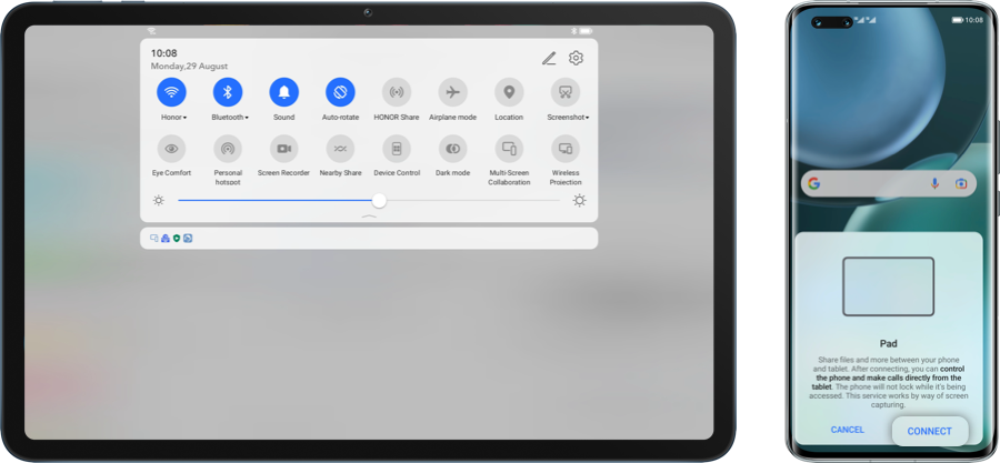

After your smartphone is connected to the network, the following two methods can be used to enable Multi-Screen Collaboration.
Connect over Bluetooth

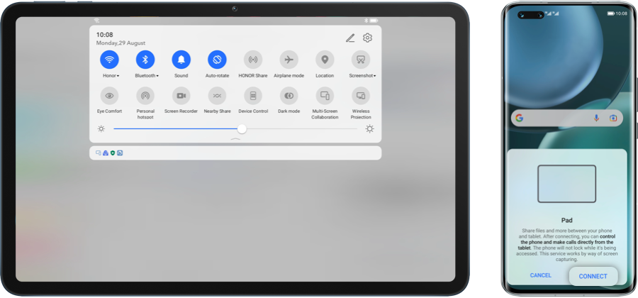

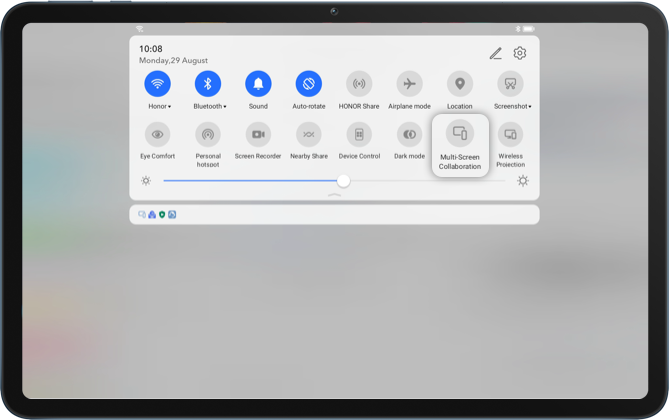

Swipe down the status bar and enable Multi-Screen Collaboration, enable Bluetooth on your phone, hold your phone close to your tablet and follow the onscreen instructions to make connection between the two ends.

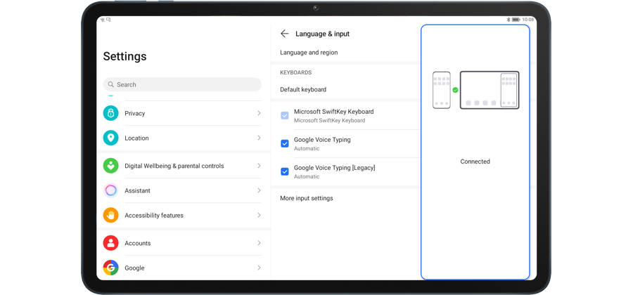

Connect by Scanning a QR Code

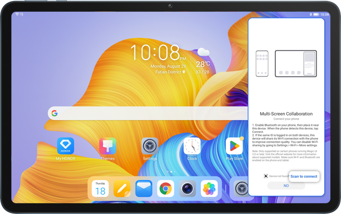

Enable Multi-Screen Collaboration on your tablet, touch Scan to connect, follow the onscreen instructions and scan the QR code on the tablet with your mobile phone to connect the two ends.

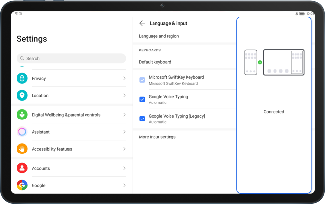

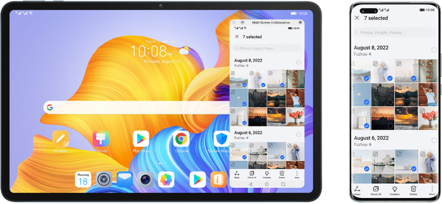

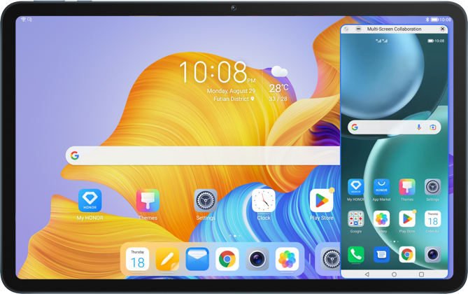

Once Multi-Screen Collaboration is enabled between your smartphone and tablet, the mobile phone screen will be mirrored on the tablet, which allows you to control your mobile phone applications on the tablet like answering calls, sending messages, etc.
You can also transfer files between two devices by long pressing and dragging the files and images. It’s more convenient when working or playing.

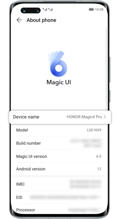

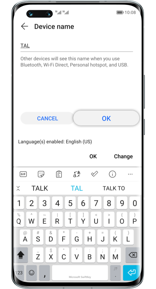

The collaborative connection between the mobile phone and the tablet may fail because the device name of the phone/tablet contains special characters or emojis, or the device name of the tablet has reached the maximum length that can be entered. It is recommended to modify the device name with letters, numbers, spaces, or underscores, and make sure that the character length is less than 30 characters.

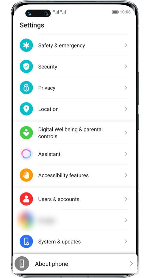

Modify the Mobile Phone Name
Go to Settings > About Phone > Device Name, modify it and click Confirm.

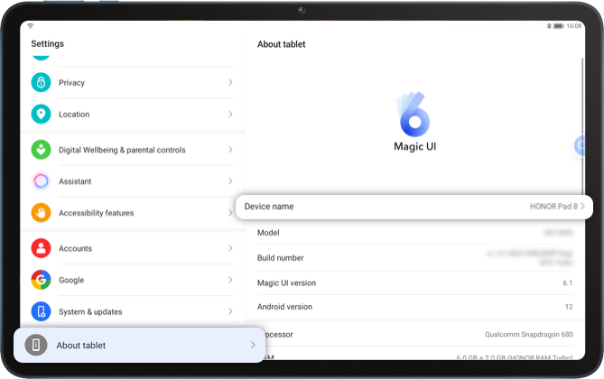

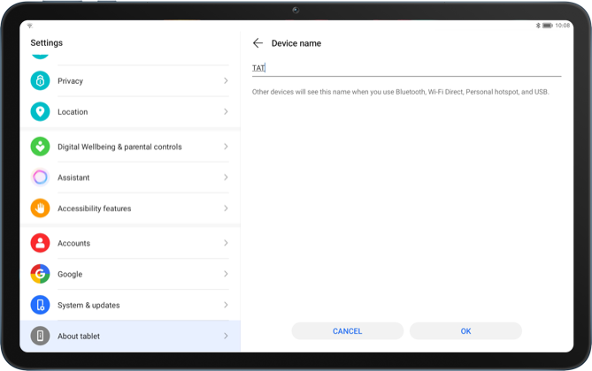

Modify the tablet name
Go to Settings > About Tablet > Device Name, modify it and click Confirm.

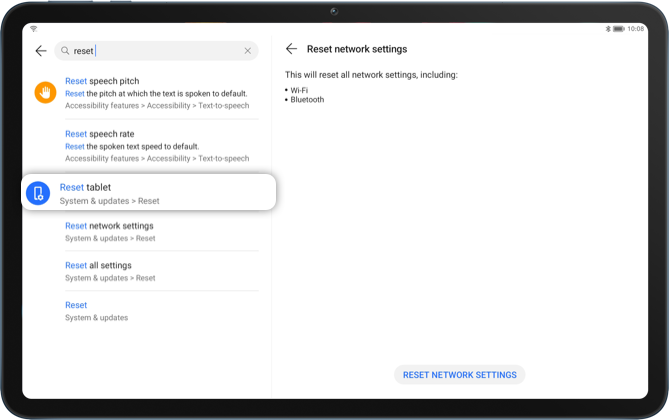

  • • If none of the above methods work, you can find settings on the tablet, search and go to reset network settings, and follow the on-screen instructions to reset it. This operation will delete Wi-Fi and Bluetooth related history and will need to reconnect to the network.

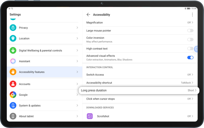

Failure to drop and drag
files from mobile Phone to
tablet

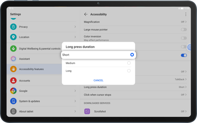

If the mobile phone file cannot be dragged and dropped to the tablet after the collaboration is enabled, and the dragging animation is not displayed after long pressing the file, you can go to Settings > Accessibility Features> Accessibility > Interactive Control > Long Press Duration, and set the delay time as Short.
