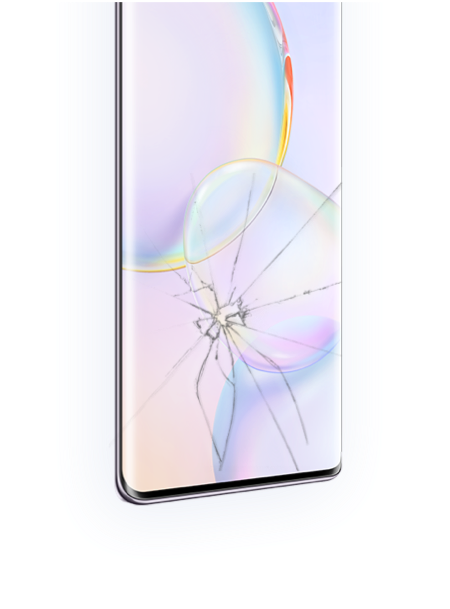

Screen cracks, especially in the unlocking area, will affect the recognition speed.

Screen cracks, especially in the unlocking area, will affect the optical in-display fingerprint recognition. It's recommended to replace your screen.
