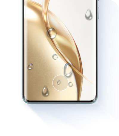

Stains and water spots on the screen or the finger will lead to poor fingerprint recognition.

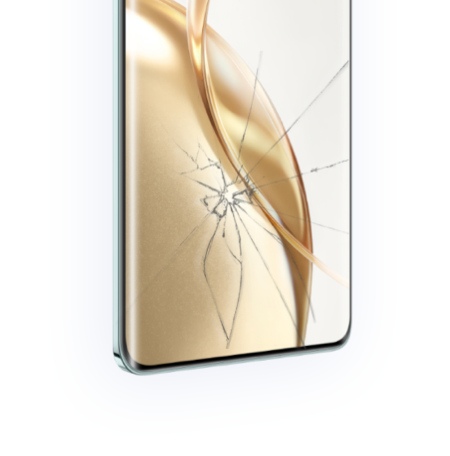

Screen cracks, especially in the unlocking area, will affect the recognition speed.

Screen cracks, especially in the unlocking area, will affect the optical in-display fingerprint recognition. It's recommended to replace your screen.
