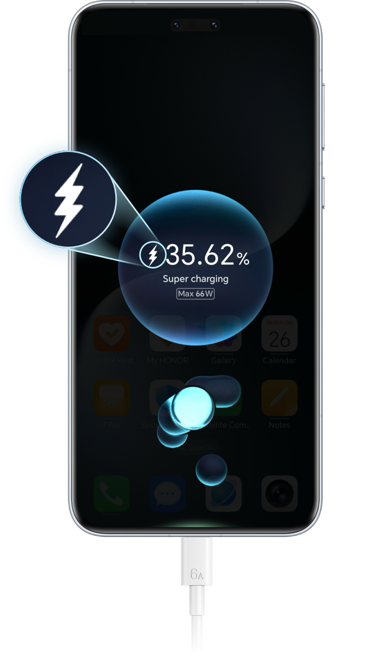

HONOR mobile phones have three charging modes: super-fast charging, fast charging, and normal charging. The lightning icon and power percentage in different modes are different.
Double Connected Lightning,
representing super-fast charging mode
Double Connected Lightning,representing super-fast charging mode

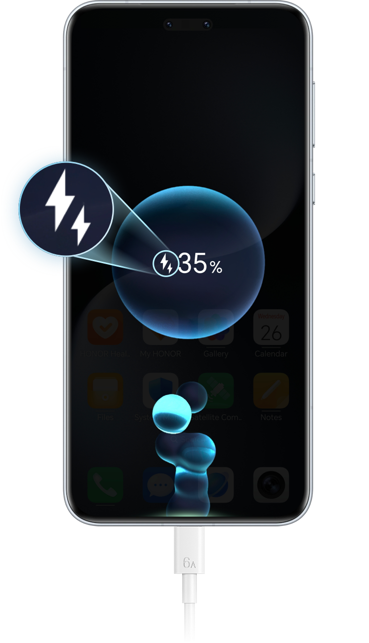

Two large lightning bolts connected together are the symbol of super-fast charging mode. At the same time, in the charging animation that appears when charging starts, the battery percentage will be accurate to double decimals. If the charging specification of the device exceeds 40W, the words "Max xxW" will also be displayed on the screen.
Two lightning bolts,
one large and one small,
represent fast charging mode
Two lightning bolts,one large and one small,represent fast charging mode
A large lightning plus a small lightning represents the fast charging mode. In this mode, the battery percentage in the charging animation is displayed as an integer.

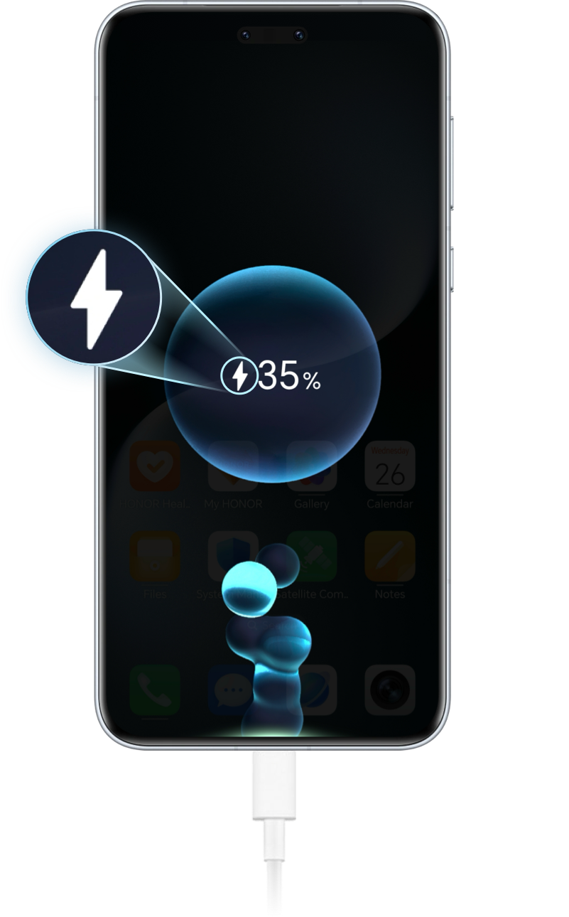

Single lightning,
representing normal charging mode
Single lightning,representing normal charging mode
In normal charging mode, a large lightning bolt will be displayed. The battery percentage in the charging animation is also an integer.
